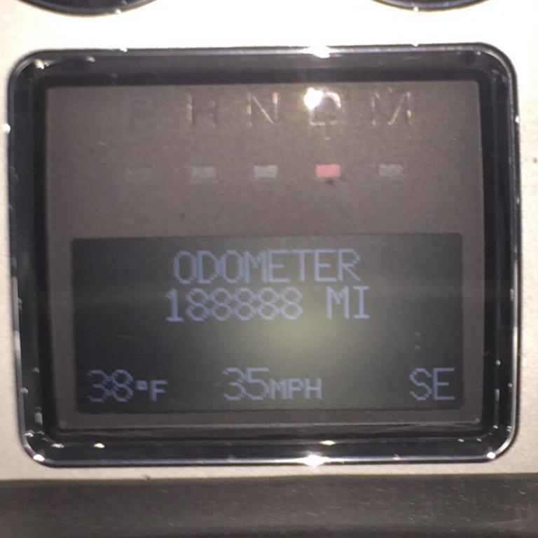

Updated mileage and just added a few more!
Attached Thumbnails post if you have 100k miles in your GM hybrid and what issues you had to get there!-image-2048121896.jpg

61,000 to go and you made it to the Moon.
does it mean I am on my second trip to the moon? first 200+k miles was with my 1988 mitsubishi galant sigma and the return trip was by my 2003 honda pilot. but I think the hybrid will make the return trip with no problems.
