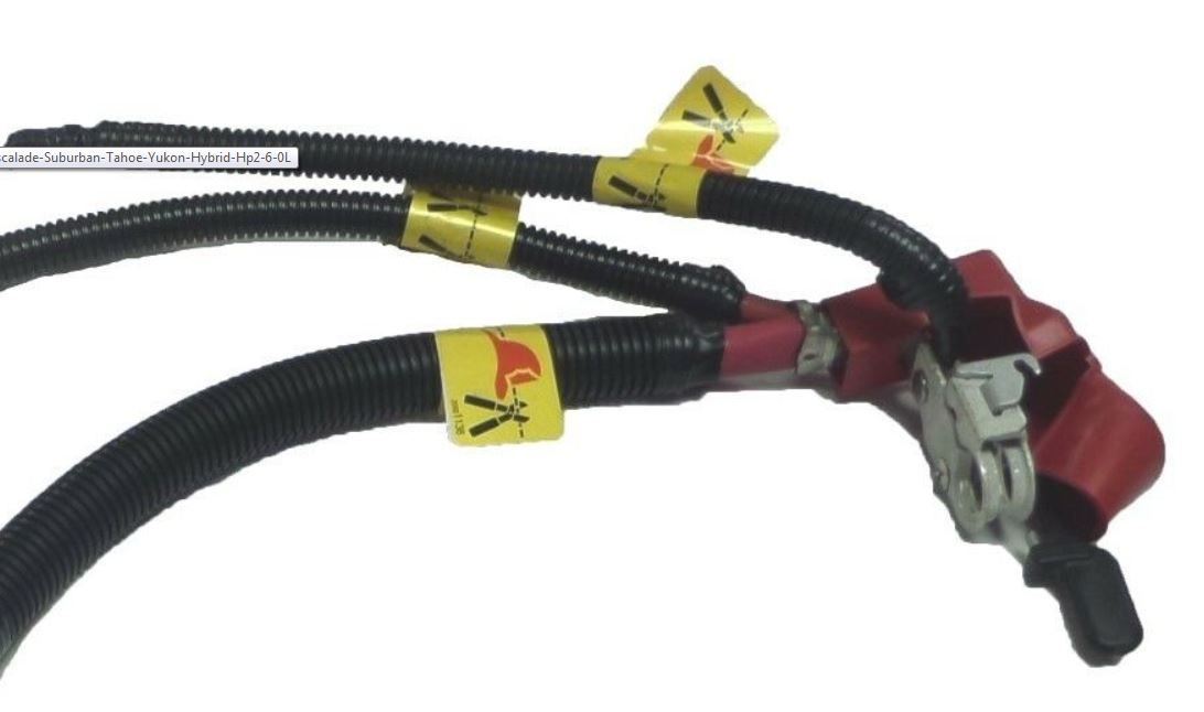

I was messing with the Cables tonight as the SUV did not want to cooperate... turns out my positive cable is damaged
well right where it connects on the battery terminals
you can see the insulation crimp coming undone.. for that to happen the cable has to be yanked pretty hard, cough cough accident..
looks like when it was in the accident (before i bought it) it has stress damage from the battery moving 50pound object at 20mph that is 300-500 pounds of weight in said accident..
it still has a pending buy back as they lied about the accident(air bag deployment)... have to call back the bond issuer on Monday... i have no faith that the air bags are genuine.. might just be confetti for all I know.
