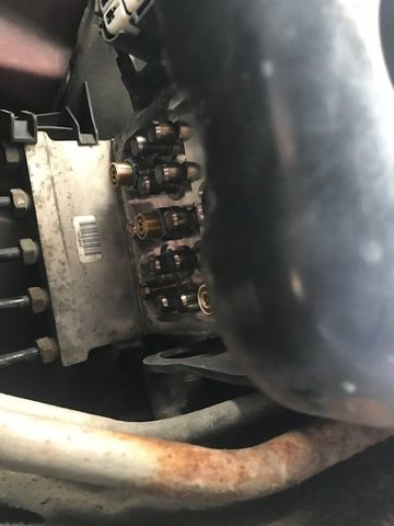

That's really good to know. Thank you! I'm still stuck with no power brakes. 128,000 miles on it. 3 codes ( C0242 C012E C0561-4B ), I've pulled and inspected the ebcm and no visible corrosion. But I wondered about flushing the system since it sat.
Probably good to do it anyway. I know a GM mechanic that works on the side, he did some looking and there is an updated file for my ebcm. Sometime next week he will try reprogram it and relearn with dealer procedure. After that I'll start replacing parts.

Yeah unfortunately on mine the damage to the inside of the ABS was bad and it could not be saved. The ABS is a J92 system 7700lb active brakes the ABS unit is not available (obsolete) if you need one you will be looking at a salvage yard part. I went back with Dot4 synthetic fluid thoroughly flushed the system hoping that it will last a few years now.
