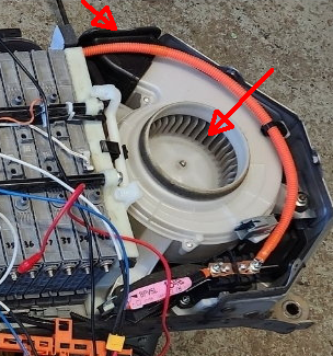

Devise a means of circulating air through the pack. Please refer to the following:
If you can suck or blow into either fan opening while blocking off the other, you can get air to flow through the pack. Anything that results in perceptible flow through the pack is acceptable - even if horribly crude. If you have a carpet dryer, you could force it into the black opening, block off the circular opening and force air up through the pack.
Alternatively, if you can suspend a box fan over the pack blowing into it while blocking off the circular fan opening, you can probably get some cooling.

I spent some time rigging up cooling. Learned something about the system.
The GM fan for the battery only pulls air from the top of the pack and exhausts out the rear ducting. Blowing into the fan ducting does nothing. Learned this once I removed the assembly.
But blowing into the air inlet on the bottom/side of the battery nicely pushes a ton of air between all the modules. You can feel it coming out with your hand.
I had a bathroom exhaust fan from a reno that I rigged in as a low cost/fairly efficient fan that even has a 110 plug on it. I was fairly pleased.

Good work. It's been a long time since I had one of those cases open, and I see my mistake.
Please confirm if you had a carpet dryer like this:
you could just aim it into the vent at the end?
Sorry for steering you wrong.

No apology needed, you haven't! I was thinking about adding cooling before so your suggestion just encouraged me to follow through. I could just tell the fan ducting wasn't the spot so no worries there.
A carpet air mover would definitely move more air, but the pack is close to a workspace I don't want a bunch of noise at. The bathroom fan is definitely forcing lots of air through and I think it's plenty.
