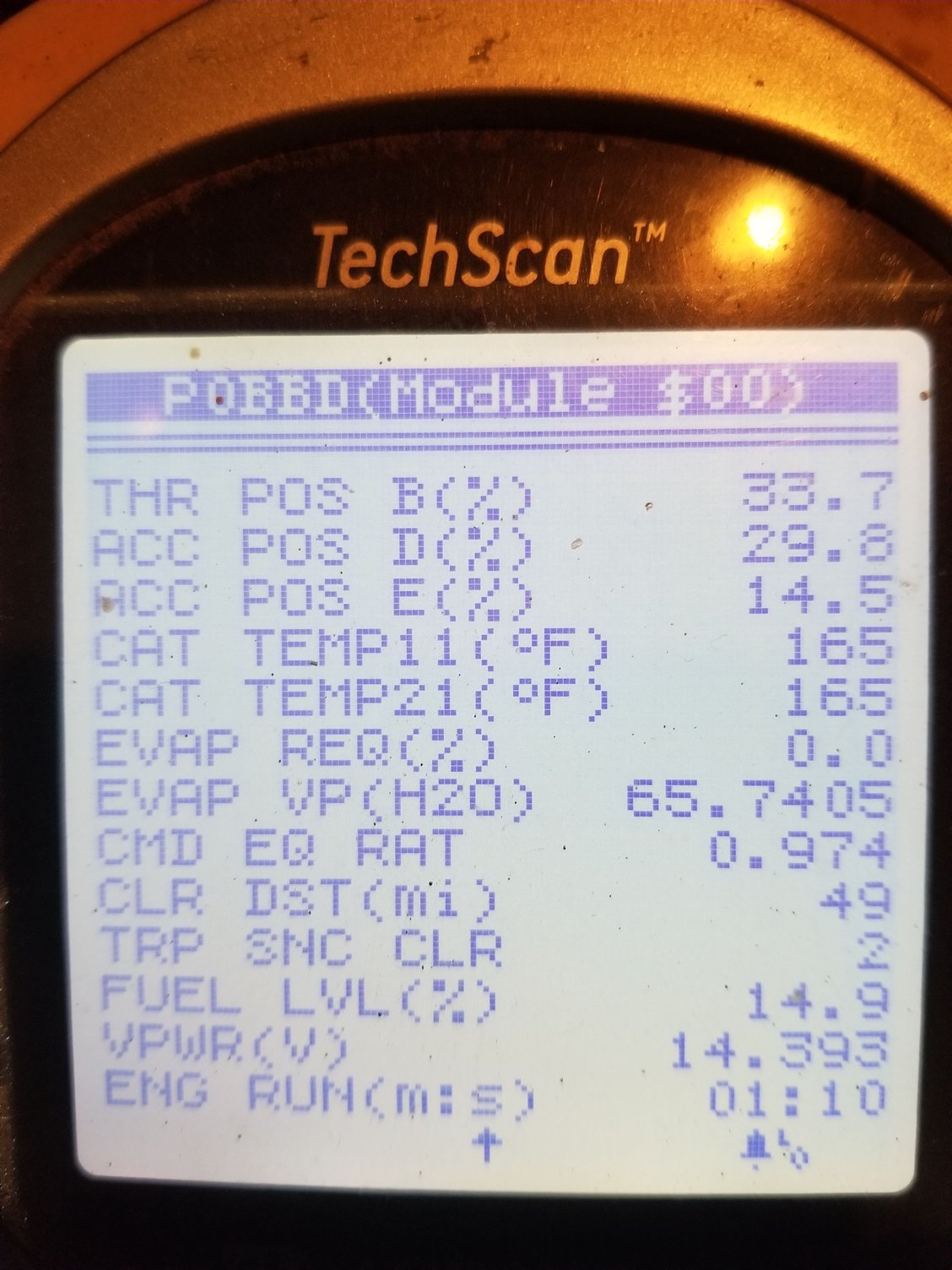

Had this vehicle for about a week. Bought it well below NADA so I thought I would give it a try.
4th day it kicked up the CEL and some codes. 5th day the same. Both were after a 45 mile drive to a neighboring town in mid morning. Both times the codes popped up on the start of the drive home in the late evening.
I'll post some screen shots.
thanks for helping out.

After removing the plastic and carpet panels and vacuuming the fan intakes. Intakes a little blocked .
This morning no start and "Service Hybrid Battery"
No codes.
Guess it's time to research batteries.
Thanks all I'll let you know if the battery cures everything
Update. The master battery disconnect lever wasn't pressed all the way down well. Discovered that when I took it out and put it back in. When pressing the lever down after rocking it up, it went down farther than it did originally.
I was able to start it up and drive it. Drove up the street to the big church parking lot and drove around till I got the temp up to normal operating temp. During the many stops to enter auto stop and accelerate forward trying to keep it under battery propollsion as long as possible I had the vehicle die and come to an abrupt stop. It did this on my wife the second time it kicked a code.
It restarted ok and I continued with the stop and starts. Tried to die once more but didnt. Sometimes it wouldn't even make it to 10 mph before the ICE would kick in while being very gentle on the accelerator.
I think the writing is on the wall but I'm still playing with it.

That is NOT a happy battery!
