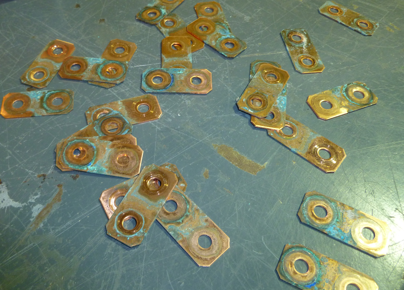

Without pulling the Hybrid battery box and testing each cell independently like I've recently seen videos online of Toyota Prius owners doing, Not so sure of where to go next. Maybe the copper buss bar connectors are becoming corroded?
http://1.bp.blogspot.com/-cHvU-HXikF...0/Bus+bars.jpg
Thanks again.
