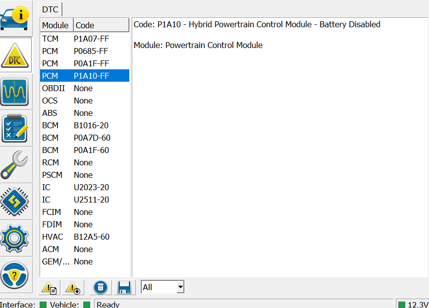

These are the errors I'm getting from Forscan (Attached at the end of this message along with some oscilloscope plots).
I do not understand every code, but it seems that the hybrid battery is slowly dying. Pack voltage is 272 V after not driving the car for a little more than 24 hours. Any input would be appreciated and if it is worth it to try to fix it (DIY or not). Thank you in advance.

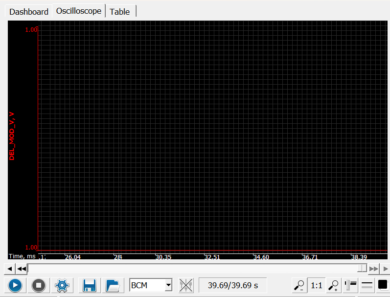

So I did two measurements. One was while the SSN wrench was ON and gave DEL_MOD_V =1 V .
Then I pressed the jump button and 8 minutes later DEL_MOD_V dropped below 0.1.
Both pictures attached.
I should also mention, that after starting, the vehicle runs just great. 30 (or more) MPG and goes on EV mode all the time. It is only when it sits for more than 24+ hours that the issues start.

Table view is more useful if you're looking for snapshot data.
You have a failed cell or cells that can't hold a charge. The only options are:
