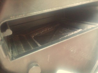

Old Dec 11, 2016 | 04:55 PM
Slate's Avatar
Joined: Sep 2016
Posts: 43
From: Tennessee
Default Re: What temperature will the blend door stay closed below? Also, A/C for battery
I checked mine this morning when it was 35 deg.F
Closed before starting.
Closed while running
Closed when it went into EV after about 10 min.
Checked again when got home from work when it was 55 deg F.
Same results as above.
Both times I didn't drive it.
Mine is an 06 MMH with 283k miles.
Mine runs excellent and goes into EV mode proper.
I get about 30 mpg with normal driving.
I don't have a Scanguage yet but want one.
When it was warm out the AC would come on proper and cool the battery.
I judged this by feeling the rear cooling lines under the car and one was nice and cold.
I will check again during the next drive.
