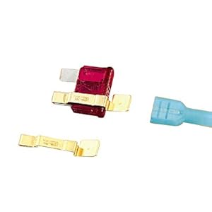

When you find a circuit in your fuse-box, your friendly auto-parts store will have a fuse-tap to connect a wire to the fuse for that circuit.
Here's one on Amazon.com: http://www.amazon.com/Wirthco-30001-.../dp/B000CQBNFI
