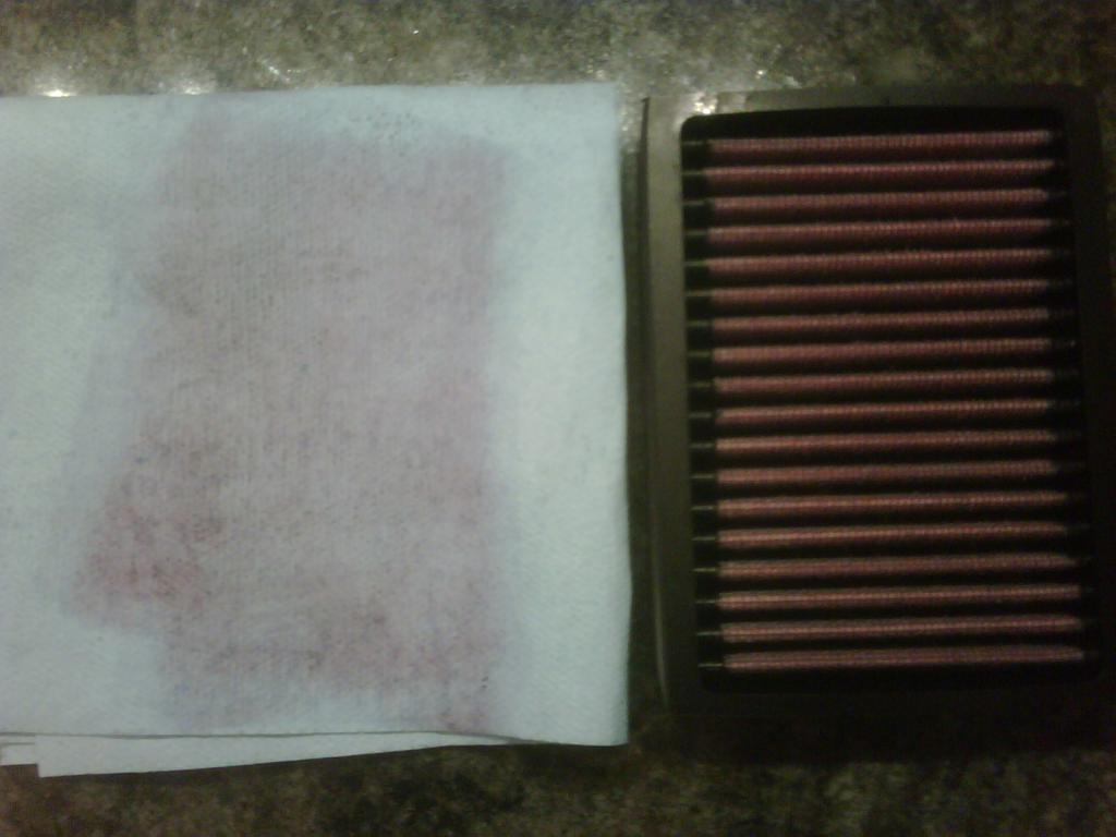

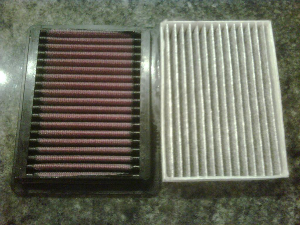

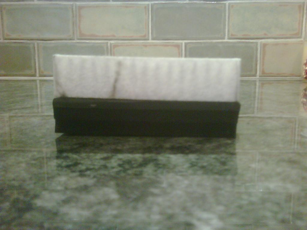

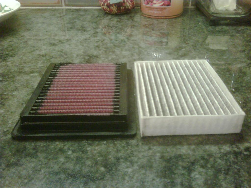

OK - I just installed the K&N filter in the rear traction battery duct. Piece of cake... But I do have some tips for those who might want to go this route.
First, the filter comes pre-oiled with a fairly liberal amount of oil. It was mentioned earlier in this thread that the oil could be a problem if it were to drip or otherwise get through into the ducting. After opening the K&N I could tell there was a pretty good saturation of oil in the element; enough to be of concern for this application anyway. I took the filter to the shop and placed a shop towel behind it while blowing 100PSI of compressed air through it from a distance of about 2-3 inches away. I did this a few times while turning it over. It left a pretty good stain of oil on the towel. While the velocity of the air going through that duct is nowhere near what I did with the air nozzle, the oil present on the filter might have been enough to "mist" into the ducting and possibly get to the battery. As Bill Winney pointed out, this could potentially cause a fire. I think that's a bit of a stretch considering the small amount of oil we're talking about here, but safety first. The filament still has oil in it enough to function quite well as designed after removing the excess.
Then I trimmed away the flanges of the filter to remove the majority of the excess and come close to the size of the original. I learned years ago as a machinist that to accurately cut rubber, you can't cut it with a blade. The best way is to grind it. After trimming it close, I used my bench grinder with a course wheel to grind the silicone in small increments to get it exactly the right size. The shorter side (see pictures) has to be trimmed to 9cm +/- .5mm or so. That side of the filter is actually pretty thick and would be difficult to cut with scissors or a blade, so I definitely recommend grinding it to size. The grinder peels away the silicone with ease and leaves a nice smooth edge. The filter is already within a millimeter of the correct thickness as made. The thickness is also the least critical dimension as the rubber sits beautifully flush against the surface of the duct, sealing it better than the original filter ever could.
From Left to Right:
Original Untrimmed filter - top view
Original filter - side view
Partially Trimmed filter with towel showing excess oil removed
Fully trimmed (ground edges) filter exactly the correct size
Installed Filter

My thought on oil in the traction battery was not after just one filter. Rather it was after, say, your 5th or 10th filter.
It is possible to have some oil entrained in the air flow, virtually undetectable, that after several filters does leave a residue inside something like the traction battery. Your test shows that oil comes through. So the issue is how much and for how long.
Using these filters for the engine does wonders as the oil assists in trapping very,very fine dirt and what gets to the cylinders is burned.

To answer your concern Bill - The idea with the K&N is that you should never have to replace it. K&N actually advises that the filter works better the dirtier it gets and you should really never need to clean it either, but if you insist on cleaning it they provide instructions anyway. So far I've followed their advice with good results on my other vehicles. It's counter intuitive that the filter is OK to let it get dirty but the "claim" is that a filthy K&N filter still flows better than a brand new paper filter. Sorry if I'm telling you stuff you already know. It sounds like you're familiar with the K&N but I was curious as to why you were suggesting that there might be a need to replace it.
Ideally there would never be any more exposure to oil in the system than just after installing a new filter. If the theory of never changing or cleaning the filter is followed (and successful) then the oil should stay in the filter.
After blowing the excess oil out of that filter I had to admit that I was glad you brought up the issue. The oil was on there pretty thick... Thicker than necessary (in my opinion) to allow the filter to function in this application. I will be monitoring this little experiment closely...
