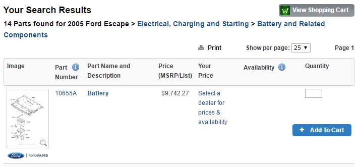

Has anyone out there actually found replacement HVB cooling fans for the 2005 Escape Hybrid? I can't find any parts on the Ford site that are inside the HVB case. A complete replacement battery is available for $10,000. Do you think they have actually sold one for that? There are some new cars that aren't much more.

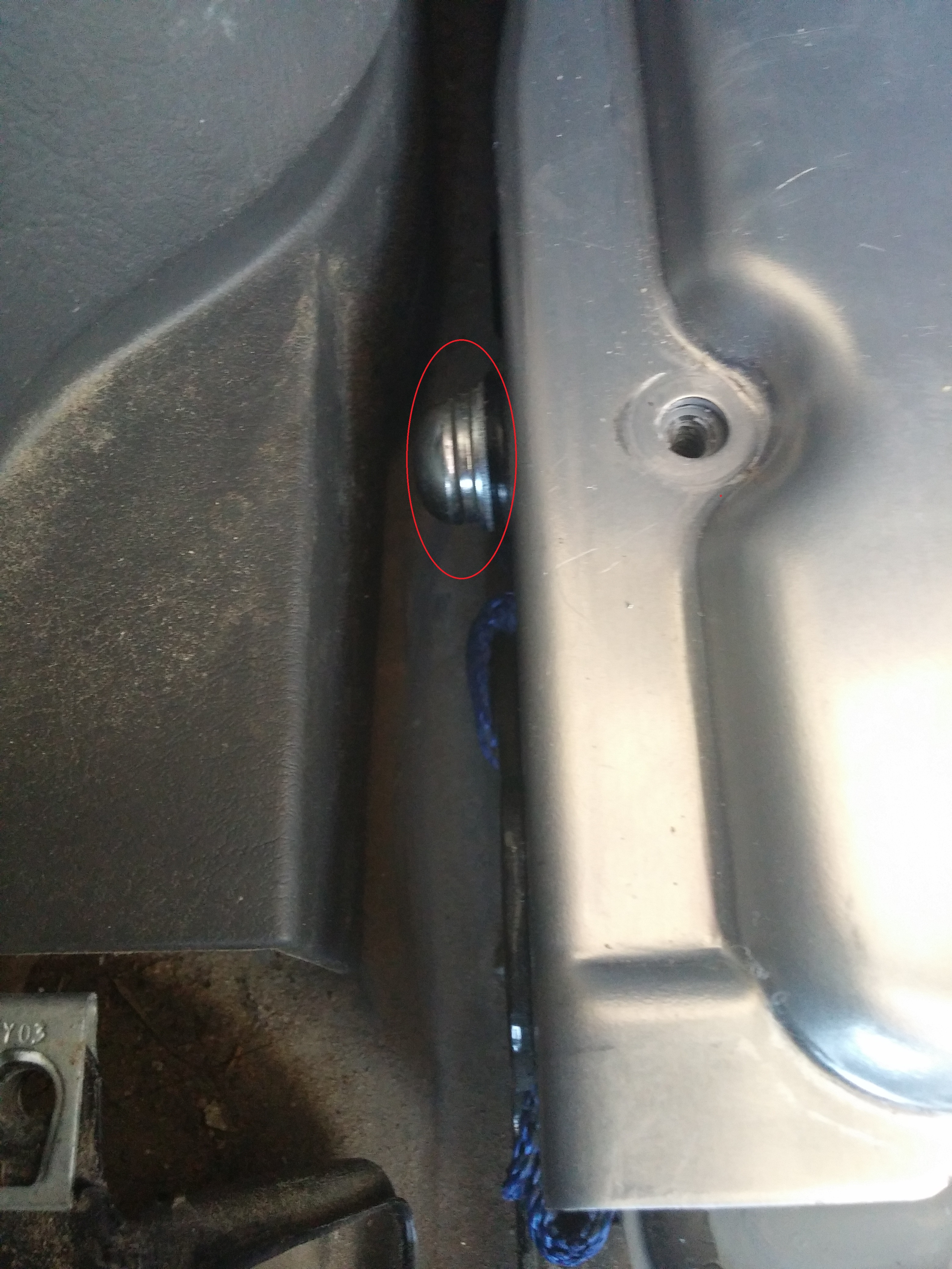

Thank you elborak. I actually found the part # a few days ago and ordered it. They updated the part # to -B instead of -A. They say it is a kit that includes both fans but I haven't received it yet. Did you do the upgrade yourself? Any tips would be appreciated. Did you remove the entire pack to do the work or by just removing the rear panel on the pack? I have already removed that panel and have full access to the fans. I tried removing the big panel covering the batteries but couldn't figure out how the 2 side screws are removed. After removing all of the security screws it was loose except for those 2 darned screws.

A link to the well illustrated guide I followed (and a description of the one small complication I had) are in this thread.
I never fully removed the large back cover, for safety reasons.
