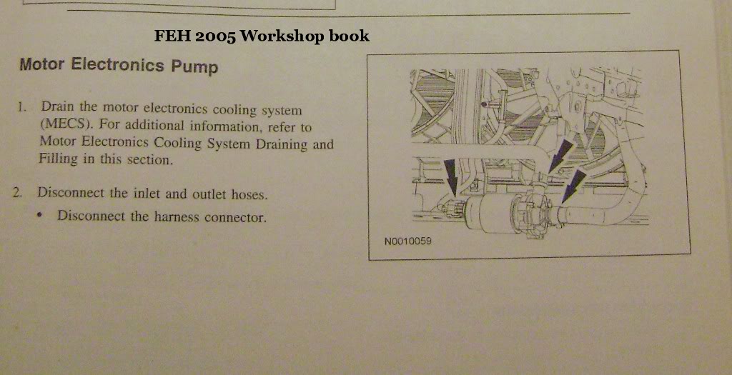

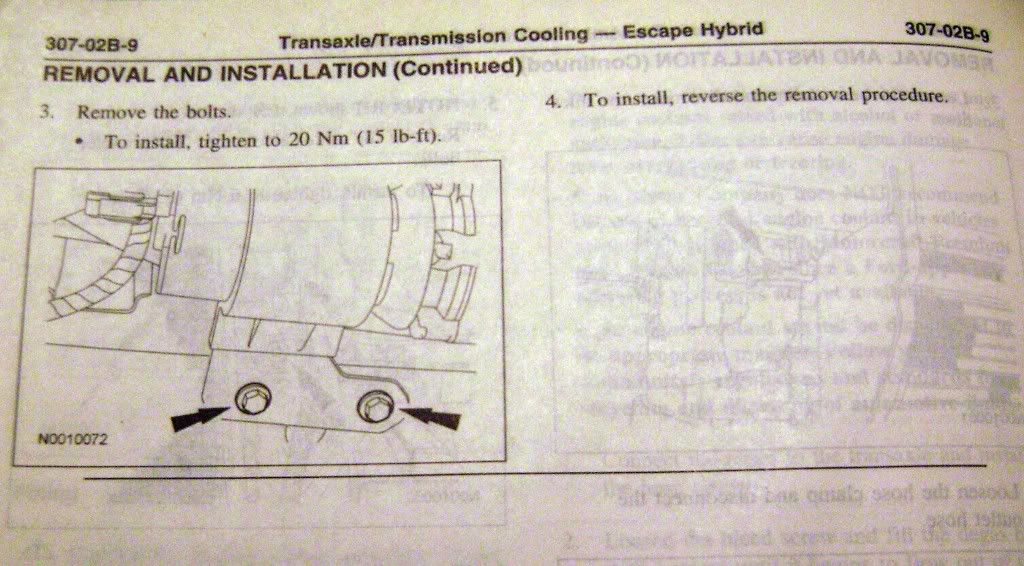

I have a 2005 FEH that does not (yet?) have any issue(s) related to the MECS pump or blend door. These photos provide instruction on how to change out the MECS pump:
Try looking at this link for additional information:
https://www.greenhybrid.com/discuss/...07/index4.html
Good luck.

Note: Unless you put the front end up on jack stands you'll find it awkward to do as the working clearance is tight. Can be done on the ground, that's how I did it summer of 09 as initially posted.
Why your mechanics should be afraid of the electric motor is beyond me, but then this shows their ignorance of the car.
While it won't be a big deal if you watch the coolant level in the MECSystem after completion, but you should vent the top of the transaxle. Probably easier to disconnect the big wiring plug that's somewhat in the way. Note the rubber o-ring on this vent plug, tighten it down but don't crush it.

You will spend most of your time removing the splash guards and perhaps 15 minutes actually replacing the pump...may as well replace the coolant given the number of miles you have. I was not able to find the Zerex coolant locally but the Ford dealer's price was competetive with Amazon once you include shipping.
Good luck!
