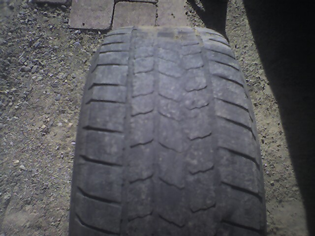

Attached is a pic of a tire just removed. This tire was run only slightly over pressure as I run them at recommended pressures. Somehow this one ended up at a pound or two higher. I got probably 95% wear out of it.
Bottom line: if you run your tires hard they will wear out the center faster. The higher the pressure the faster they wear out the center.

Hey, everyone's entitled to voice their own opinions. That's why I like reading the posts in this website so much. Bill, what vehicle is that tire in the picture taken from...FEH? And how many miles did that tire go at the slightly higher pressure? My FEH has +40K miles and I rotate my own tires. I've always run above the Ford recommended pressure, fluctuating somewhere between 38 and 42 psi. I've never seen that kind of wear on my tires.

Wear all depends on the tire, not considering alignment.
I ran my original Continental EcoPlus tires at 48 to 50 psi and got 80,000 miles out of them.
I The ran a set of Michelin Lattitutude Tours at the same and got 25,000 miles, but the corners wore first. Alignment was checked, and was on the high end of within tolerance.
Run my Protenza tires on my Honda Insight at 50 psi.
Got 50,000 miles out of an advertised 40,000 mile tire with even wear.
Generally speaking, on the MAJORITY of cars, people get less tread life running at "recommended" pressure. The recommended pressure is a compromise between several aspects. You can trade less comfort with higher pressure SAFELY if you wish to gain more mpg, and in general, longer tread life.
There are exceptions. You have the ability to try it for yourself.

My factory tire recomendation is 32x4. It's like driving across a soft sandy beach. I run all my tires up to max sidwall cold pressure. My factory Dunlops are ran at 50 PSI. The first set lasted 80,000 miles, the second was changed around 130,000 miles and now I need a new set at 200,000 miles.
I've gained around 7MPG for the added pressure across those 200,000 miles.
The biggest contributor to balding tires is front end misalignment.

The tire is from my FEH at 60,000 miles on the car. Probably had only 5-10,000 remaining based on the other tire.

You're a big joke telling guy I think? Those tires are not from your FEH and you can't read or understand Law.
