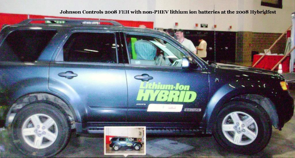

This might be an old topic or "off" topic but it can be repeated. Johnson Controls Saft--the company supplying the PHEV lithium ion batteries to the at least 22 "fleet" PHEV Escape Hybrids running loose in this country--did approach Ford Motor Company at or prior to the 2008 Detroit Auto Show about "upgrading" the existing hybrid battery pack. Our FEH Michigan journalist-Rich "Pravus Prime"-reported this and the "basic" details were $3000 for non-plug in upgraded batteries, software upgrade and removal of the "heating and cooling" stuff inside the battery pack. This link from greenhybrid: https://www.greenhybrid.com/discuss/...control-20391/
will rehash part of what I just posted. I understand it as a Johnson Controls Saft FEH --with their non-PHEV hybrid battery pack--was at the 2008 Hybrid fest and I remember reading a 42mpg figure at 65mph for this vehicle.
I was not at either the Detroit Auto Show or HybridFest in 2008. It might be possible I have incorrect information.
