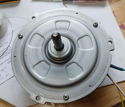

Step 1: Remove the 3 nuts on the bottom of the fan so you can remove the bracket and ground wire
Step 2: Flip it over and remove the 9 Phillips head screws to allow you to separate the two halves of the shell.
Step 3: Place a small drop of oil on the inside lip of the lock washer to help it slide better. Get a pair of pliers so you can firmly grip the outside edge of the washer, but do not squeeze too hard - you don't want to mangle it. Twist back and forth while you lift and it should slowly slide off.
Step 4: Figure out a way to remove the fan cage from the spindle. I used a long screwdriver and slowly worked it upward by twisting the screwdriver. Take care not to break the plastic cage. Thankfully, it was flexible rather than brittle.
Step 5: Remove the 3 larger screws on the metal fan housing. These are longer screws that go to the rubber bushings on the other side.
Step 6: Pull the motor from the plastic housing and then remove the 3 smaller screws
Step 7: Gently lift up on the top plate. The plate is glued to the top of a heatsink on the board inside. Slide a screwdriver in the gap you created by lifting the plate and pry the heatsink down off of the top plate. Note that the heatsink is directly opposite where the wires enter the housing. You wont be using the heatsink again, so don't worry about damaging it. however, try not to lift too high on the top plate when you're working the heatsink free. You don't want to break any of the windings on the motor.
Step 8: With the top plate removed, you should now see the circuit board. It is connected to the motor by 6 wires that lead to the coils. Desolder these. Each wire is wrapped around a stem on the board. Take your time to unravel them while you're desoldering. You'll want to keep as much slack as you can get, so avoid cutting them.
You're done with disassembly. You can pull the rotor out of the motor if you'd like. Be aware that the black part of the rotor is a magnet, so it'll want to catch on the metal casing. The rotor has 2 bearings, be sure to test both of them to see if they're bad. Replace them if they need it (mine were fine).

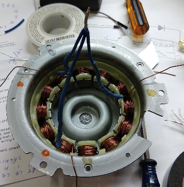

Before you start soldering, you should first verify that the windings are good. Take a look at the first picture of the Repair. You can see how i marked each phase with colored dots (yellow, orange, black). Take your multimeter do the following tests:
* Yellow to yellow for continuity
* Orange to orange for continuity
* Black to black for continuity
* Yellow to orange
* Yellow to black to ensure no short
* Orange to black to ensure no short
* Yellow to the metal case to ensure no short
* Orange to the metal case to ensure no short
* Black to the metal case to ensure no short
If all of the above tests passed then you're ready to start the repair. If you found a short then you can rewind the windings. I had to do this on one of my motors because i pried up on the circuit board without desoldering the windings first. Each of the windings broke too far down to reach so i had to rewind the whole motor. It's not hard, but it sure is time consuming.

Step 1: Straighten out each of the 6 leads with a pair of needle nose pliers. Take note that one side of each color will exit on the outside of the coil, whereas the other side of the color will exit from the center of the coil. Take the 3 centers (as marked in picture) and solder enough wire to the ends of them so you can later connect all 3 together and still be able to tuck them out of the way.
Step 2: Cut the wires so that they're all the same length. Now solder them together.
Step 3: Spread the connection apart so you can tuck each wire out of the way. Try to use the white plastic tabs to pin the wire against the wall. You don't want the wire to touch the rotor while it's spinning.
Step 4: Cut 3 equal lengths of wire. Solder each wire to one of the 3 remaining leads coming from the motor. Place the rubber grommet back in the metal case and tuck 3 wires into it so they don't get damaged by the metal case.

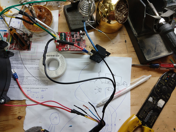

Step 6: Take your Ford circuit board and cut the wires off as close to the board as you can. The board is now garbage. Tape up or shrink wrap the ends of the Gray, Yellow, and Tan wires. These wires will not be needed for the repair.
Step 7: The controller board company has tinned the ends of the wires on their connector. This makes it an incredible pain to strip the wires. Cut the tinned tips off of the wire (go a few millimeters into the insulation since the wires soak up the solder a bit). Strip each of the wires, but be careful not to pull them out of the connector.
Step 8: Solder the White, Green, and Yellow lines from the motor to the fan controller's connector. You can now test that the fan controller works properly by connecting the Red/Black wires to 12v. Be sure to connect the potentiometer and spin it all the way clockwise. The fan should spin up and a red light should illuminate on the board. If it doesn't double-check your wiring and possibly send it back as defective.
Step 9: Crimp a blue female spade onto the controller's Red wire. You can connect this to Pin 87 on the relay.
Step 10: Solder the resistor to the middle pin on the transistor. Try to solder quickly so you don't overheat either component. Use alligator clips as heatsinks if you think you may take too long.
Step 11: Take the Ford harness and solder on 2 extensions to the Red wire. One of the extensions should be a similar gauge as the original. Crimp a blue connector onto this wire and you can then connect it to pin 30 on the relay. The other wire can be a smaller gauge.
Step 12: Take the black wire from the Ford harness and connect two extensions. One extension should be similar gauge. This one gets connected directly to the Black wire on the Controller's connector. The other wire can be a smaller gauge. It will get connected to pin 1 of the transistor. If you're holding the transistor so the flat face is toward you then pin 1 is on the LEFT (i have it backwards in my picture).
Step 13: Connect the Blue wire from the Ford harness to the end of your resistor. This is the trigger wire from the computer that turns on the circuit when the fans are needed.
Step 14: Connect a wire to the last leg of the transistor (pin 3 .. if looking at the flat face then it's on your Right). Now connect 2 extensions to that wire (can be smaller gauge). Crimp a red spade onto one extension and connect it to pin 86 on the relay. Solder your diode onto the other extension. It is important that the end of the diode with the stripe should be facing Away from the wire.
Step 15: Grab your Red wire from the Ford harness (you already put on 2 extensions). Take the bar extension and add 2 more extensions to the end of it (can be smaller gauge). Connect a spade to the end of one wire and connect it to pin 85 of the relay. Connect the other final wire to the end of your diode (the end with the stripe).
Step 16: Your circuit is now done! Here's how the final assembly should look.
Step 17: If you want your fans to always run at full speed (i did) then you can cut your the potentiometer off of its wire. Then solder the 2 wires together like in the schematic to set it at full speed. If you want it to run at some other speed then you have a couple options. You could spin the Pot so that it is on the speed you want and just leave it connected. Or, you can use a multimeter to read the resistance between the two main wires (the ones connected in schematic). Then cut the Pot off the line and solder in a resistor between those 2 wires to match the setting you liked.
Step 18: There are a ton of electrical connections exposed on the board and the relay. My choice was to cut a strip of blue shop towel and wrap it around each the relay and board individually. I then used electrical tape to secure the towel to each component. This should prevent it from touching anything in the car.
Step 19: Reassemble the fans (reverse order of the Disassembly guide)
Step 20: Install the fans into the car and give it a test. Be sure to tuck everything out of the way so that the black plastic shroud that goes over the fans doesn't hit anything. Be careful of your transistor leads. They're fragile.. i broke one when re-situating things and had to replace it. Note that if you just started your car and have yet to move the car then the fans will not turn on until the battery hits 85F. If the fans are over 75F and you drive over 10mph (even for a second) then it will turn on the fans until they drop below 70F. I would just start the car and drive to the end of my driveway and the fans would kick on and then i'd backup to my parking spot again and leave the car running while i evaluated the results.
