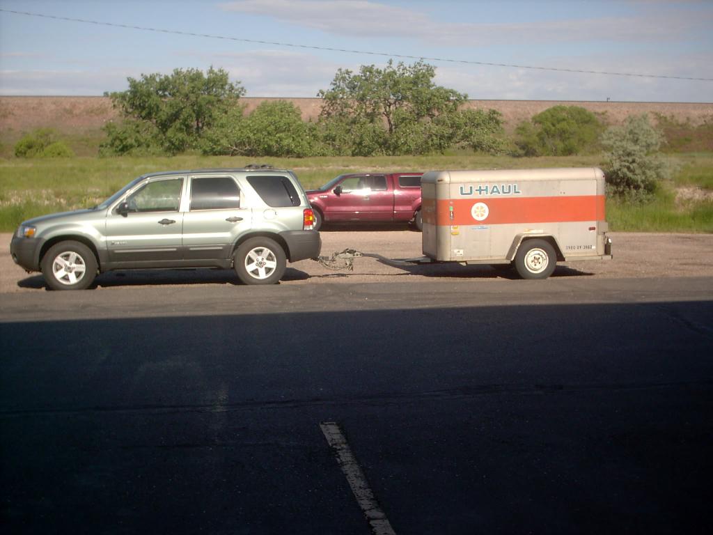

Photo attached... like I said the aerodynamics of a rounded brick...

Well there you have it.
You towed roughly one-third the weight as I did, in a trailer with probably one-half the frontal cross section. 23 MPG is totally on par. Mine is 7' wide x 9' tall x 12' long. ( length being least significant )
As a suggestion, perhaps you could proof-read your posts for clarity before hitting "submit"? We all know what we meant to say when we type, but sometimes we don't put down in black and white exactly what we meant to say. Then I need not correct "mistakes" that were not mistakes, just mis-prints.
Drawbar load is a good one, but one nearly impossible to know, being a dynamic value. At rest, the drawbar load is zero on level pavement.
A certain value at 10 MPH, and a totally different value at 55 MPH.

Dare I say on further examination that the U-haul pictured was one-third the frontal area, ( of mine ) and completely within the aerodynamic "shadow" of the FEH? 23 MPG might be a tad lower than expected. I forget... is your AWD? Probably on par for AWD and 2 MPG lower than I'd expect from a FWD.

I do proof read my stuff, not that I always get it right... I chose tongue load intentionally to differentiate it from tongue weight... On reflection I should have used "drawbar load."
Don't forget there is static loading and dynamic loading. There is a design maximum grade all of which figures into the GCWR.
Regarding frontal area: the aerodynamic flow over the top of the FEH results in a downturning of the air into the gap between the trailer and the FEH. This partly borne out by my experience with my Suburban.
With my Suburban and 6x12 U-Hauls I see that the actual load inside the trailer makes little difference in MPG. W/O trailer I get 15.5 on interstates and W/Trailer I get 11.5 but, though I am sure there is some difference due to empty versus loaded, it really doesn't seem to show empty versus loaded. Recently I towed a 5X8 U-Haul behind it and... voila... got 11.5 mpg. I attribute this to the major increase in aerodynamic load.
I think the bigger difference was the "cleanliness" of the load. Even though my 4x8 was smaller frontal area than yours, the open trailer and random arrangement of load makes for more interference aerodynamically and at highway speeds that makes a big difference (remember the equations are cubic - so doubling speed increases aerodrag by 8).
I really don't think there is the shadow you speak of. (Yes there is one, but the space between the FEH and trailer is so large that its of little advantage.)
Yes, mine is an AWD.

I agree the towbar on a U-Haul is exceptionally long... probably to reduce weight ( leverage ) and make it acceptible to more vehicles. Also, makes it easier for the human when connecting and disconnecting.
However, even at 10 feet back, the trailer is getting one helluva draft from the FEH at highway speeds. Not perfect, but significant.
And turbulent air produces less drag than still air... but it's mostly getting a draft benefit. The FEH gets a significant benefit ( like 15% ) 100 ft. behind a semi at 60 MPH.

Couldn't disagree more.
The downturn of airflow from the roof of the FEH occurs within a few feet. The FEH is so short that the air flows up and then back down in a relatively smooth and continuous curve. (Need to ensure you differentiate between skin friction and bulk flow of air here.)
This is noticeably different with an 18 wheeler. The truck & trailer combination is so long as to leave the airflow somewhat stable in a straight line when it passes over the back of the trailer. It then takes a bit longer to begin downflow.
It is true that turbulent flow has less drag than laminar flow, but I suspect that if you run the numbers you'll find that nearly everything you do with a car operates in the turbulent flow region. (I know what some car companies advertise with wind tunnel demos... but none of us drive in a wind tunnel.)
As I have mentioned from my towing experience with my Suburban, I believe the dominant resistance, at speed, is that of the impingement of the downflow from the FEH into the front of the trailer.
