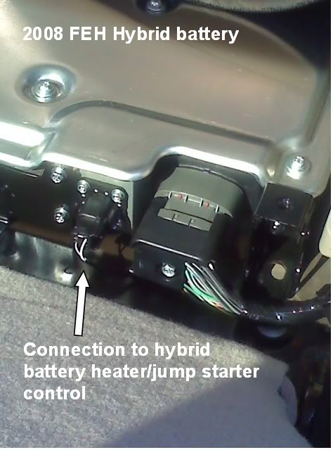

This heater had a wire to connected to the engine block heater (option 41H) for the 05-07 vehicles. Early in the 2008 production run, Ford eliminated the the wired connection to this hybrid battery heater as shown in the photo below:
Combining a timing device with the plug in engine block heater can enable one to start the vehicle with the hybrid battery temperature around 60F and engine coolant at 100F.

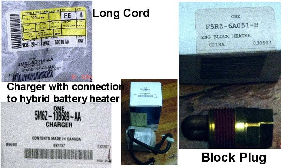

This is option 41H:
I do not know what components from this photo you need on your vehicle.
Old Jan 29, 2011 | 09:00 AM
Default Re: Battery heater
Originally Posted by subdewd
One more quick question, did you actually measure the current when it was plugged in? For the charger itself that is. thanks again
There is 75 watts only going to the hybrid battery heater-thus the small wire. There is something like 400 watts going into the engine block plug. GPSman1 was the first to post this information back in 2007.
