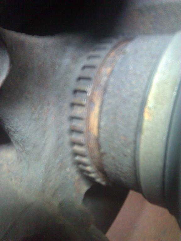

RIGHT SIDE TONE RING IS JUNK!i need a or a
Attached Thumbnails Abs light on then off  then car skidding light flashing on/off-wp_000776.jpg

I cleaned mine up and used epoxy to glue it back it place. When I got around to replacing it (just the ring) a few months later, the epoxy was still holding tight. So, don't panic dude.

I replaced my front tone rings at 49,000 miles and have not had an issue since.

for now i eill replace the 2 front then later i will do the 2 rears.
