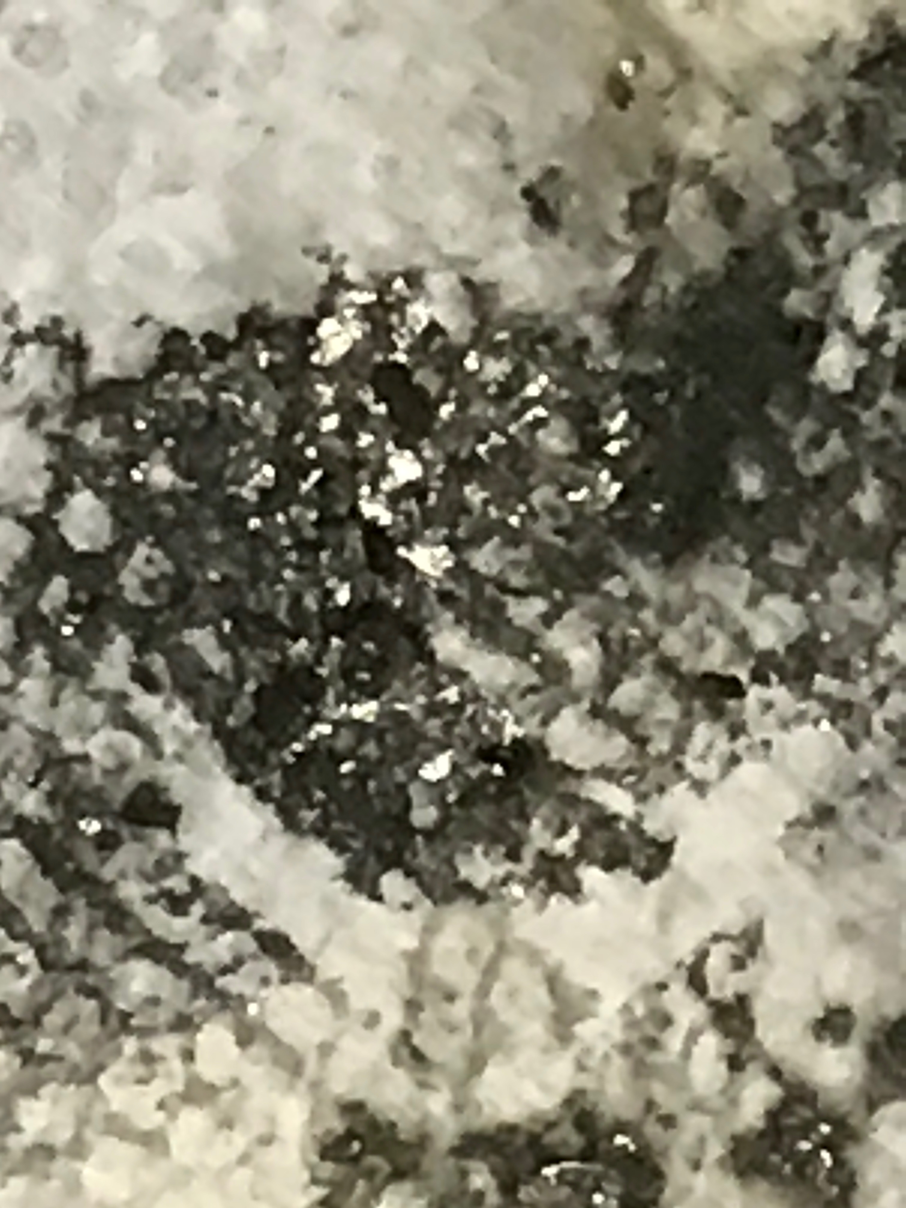

Found lots & lots of fine metal flakes in the drained fluid. With car in park, rear wheels up & checking the tone rings I rotated the rear wheels. The propeller shaft would rotate. It shouldn't have rotated. The lack of PIDS and the loss of 4WD when wheels slip only to restore when on solid surface are symptoms.
Conclusion the gears have worn thru.
With no indication of fluid loss but fluid in fact gone, I've concluded that the proximity of the exhaust piping to the transfer case tells me that the fluid slowly evaporated due to heat. So I'll start checking fluid level about every 25k.
No, the drive shaft shouldn't rotate at all, your driving and driven clutch plates are fused together. The procedure if one gets a Full Lock Condition is to pull over till it cools down and the condition rights itself. Since it didn't, driving it when 100% torque going to the rear, you probably blew the transfer case. The drive shaft is powered by the transfer case all the time.
The metal flakes are from your clutch plates. One plate is normally steel and the other is copper coated steel.
The operational check from the Ford manual is for a tech to command 100% rear wheel torque and drive at low speeds, if it resists turns, it's working correctly. The most torque that should ever go to the rear is 50% if you go higher, you have steering control problems.

Default Re: 4WD Lockup/Disable
Is that the transfer case fluid or the rear end fluid though?
