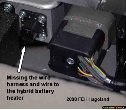

Hybrid battery warmer? Pull the cargo carpet in your 2010 FEH and take a look at this:
or does your 2010 look like this:
Those with the 2005-07 and a few in the 2008 model year have the wired connection to the hybrid battery heaters that works with the engine block heater-option 41H. This feature was dropped early in the 2008 model run. It is unlikely the 2010 version has this wired connection in place. No one with a 2010 has confirmed this as of yet.

Billy, finally found that connector in the pic. You have to flip down the drivers side rear seat to see it. I do not have the other connector for the heater.
Thanks.
