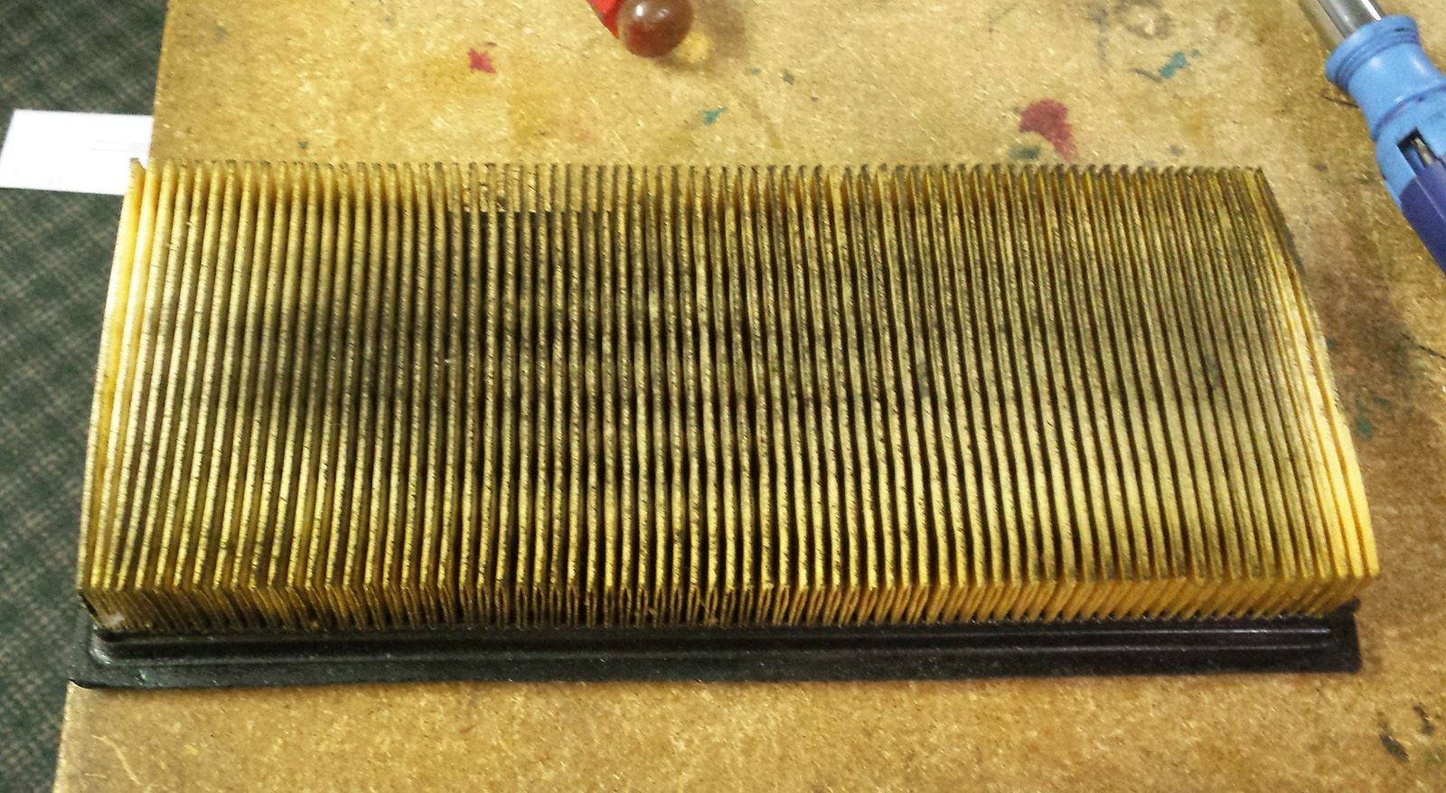

Today I changed the engine air filter on the '10 FEH, I'm getting close to the 60k mile mark and plan to do the oil and eCVT fluid next, but I got the filter from Amazon this week and decided to change it. The existing filter was pretty dirty but not excessively so. According to my records it was changed at the 30k service interval. It's an easy job: pop the clips on the left side, pull the housing and tabs to the left, while lifting/tilting the cover enough while still leaving the snorkel attached and ease the filter out. I was astounded to find a few rather large chestnut shells rattling around in the bottom of the housing along with some other minor debris. Had a mouse been in the bottom of the airbox at some point? I didn't see any other evidence of the little rascals, so I tossed the shells and vaccumed out the inside of the housing with my shop vac. Weird.

2010 FEH Limited ICE Filter ~ 30k miles
