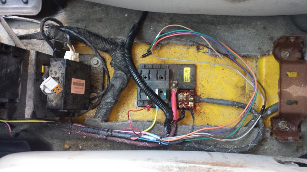

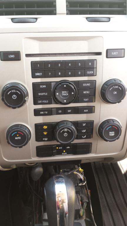

I have 2008 FEH and I can't find the fuse for the climate controls. The temp controls don't appear on the lighted dash and the fan doesn't run. The radio works fine. This vehicle was a former lifeguard vehicle so it has a ton of extra wires and there is a permanent power source I can connect and get them to work, but I think it shorted out the regular temp (power when vehicle is on) fuse. I looked at a fuse guide and checked fuses 15, 29, 39, and a few others, but all are fine.
I've included pictures and I have a few more electrical issues like the airbag light and the tire pressure monitor too (all from the salted beach water for sure). The pictures are; electronic readout, controls at the bottom are the ones not functioning, and the mess of electric I'm dealing with. The red and black wire in the extra fuse box is the one that is permanently connected to the battery and is the only way to get the controls and the climate controls to work.
