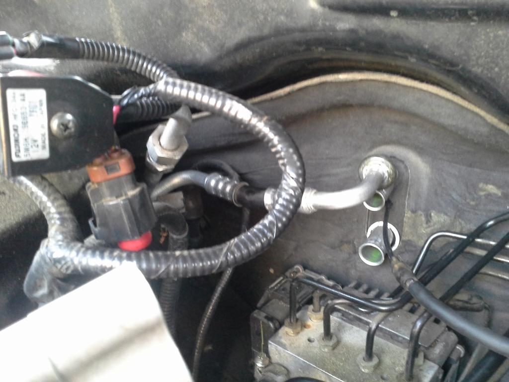

I am in the process of changing the compressor, drier, and orifice tube on my Escape. I have the compressor installed and am ready to do the orifice tube, but for the life of me i can't find it.
I have opened up both lines going through the firewall to the evaporator and neither one had an old orifice tube in it. Does the Hybrid version of the escape not have an orifice tube??
If it does, does anyone know where it is located.
I have attached a few pictures of the current state of the installation. I am waiting to get this part done before i install the drier so i can take it directly to the shop that evacuated it and have them recharge the system.
Thanks in advance for the help.
Attached Thumbnails 2005 Escape Hybrid A/C Orifice Tube-20130626_195505.jpg   2005 Escape Hybrid A/C Orifice Tube-20130626_195520.jpg

It should be in the high side line that goes from the receiver/dryer/accumulator and the evaporator. They do have a special removal tool for that but I'm unsure if something else will do.

After a little more searching in the Interwebs and looking at some diagrams i found the orifice tube.
It is in the high pressure line going to the evaporator like everyone said. My Haynes manual made it look like it was at the connection right at the firewall but it is further upstream than that. There is a compression fitting upstream of the A/C tube fitting that you have to undo. Once you open that part you'll see the orifice tube.
The connection is right after the solenoid valve on the high pressure line.
Changed that, buttoned everything up and took it to the shop to have it recharged. Blows really cold now and the engine is turning off almost everytime i stop which it did not used to do. Guess it was not able to cool the battery enough to allow it to go into EV Mode.
