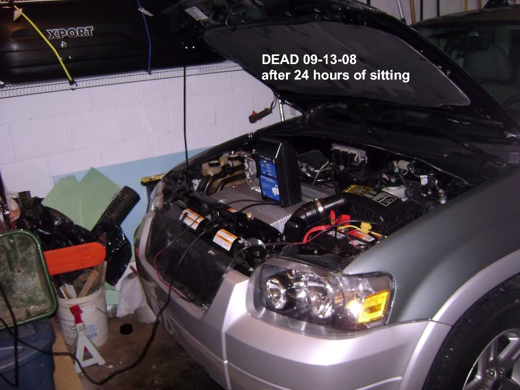

Does the 12V battery need sufficient charge for the Escape to start? Take a look:
My hybrid battery had normal state of charge. My 12V battery had less than 9 amps.
