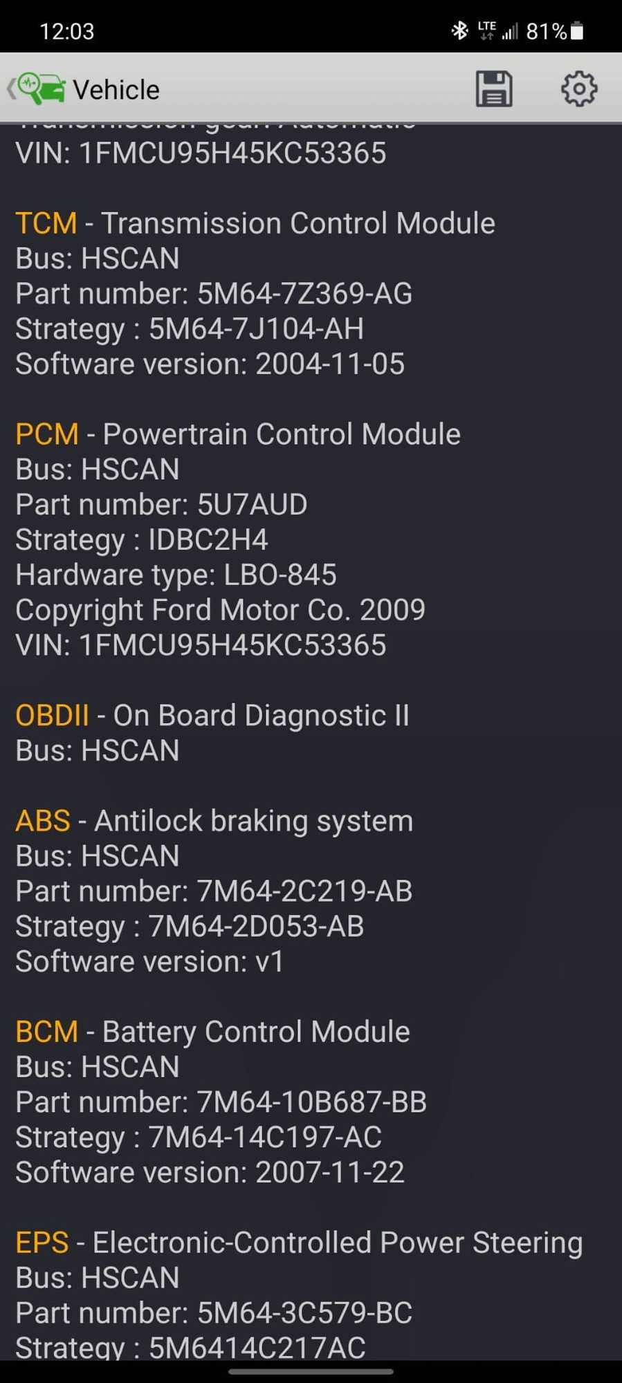

His SOC is excessively high though. Car is charging up and not using the battery. Avg of 70s. I wouldn't change the CV until you figure that part out. Dunno what else, update the PCM?
Yeah. That bothers me too. I don't know what to make of that at all. He got the high SoC of 80%+ after running Battery Rebalance on FORScan which he reported terminated *early* at 13 minutes. Mine took 23 minutes. It's supposed to charge that battery to a high state of charge and then gradually BRING IT DOWN to normal before terminating. I don't think that happened on his car. For some reason, he seems to be able to get current/voltage into the battery, but not out of it. And even though it ended quick, it didn't show any error messages!
So the system thinks it's 'nominal' but the energy is almost a 1-way street.
Ford dealer? New BCM? I'm totally stumped.

I wonder how many updates there are to the PCM. I'm curious comparing my specs and software versions to yours Shady. Attached is the PCM,TCM and BCM information along with my last Forscan analysis. It should be noted that this is a previous government vehicle. I don't think it has seen the dealership as most work is done through their own city yards. Its very possible some updates are needed.
