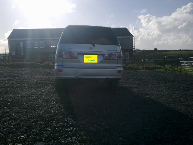

Front veiw

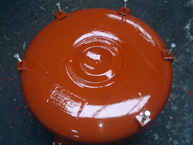

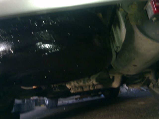

Tank primed and then undersealed

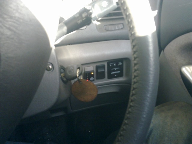

Change over switch mounted in spare switch blank

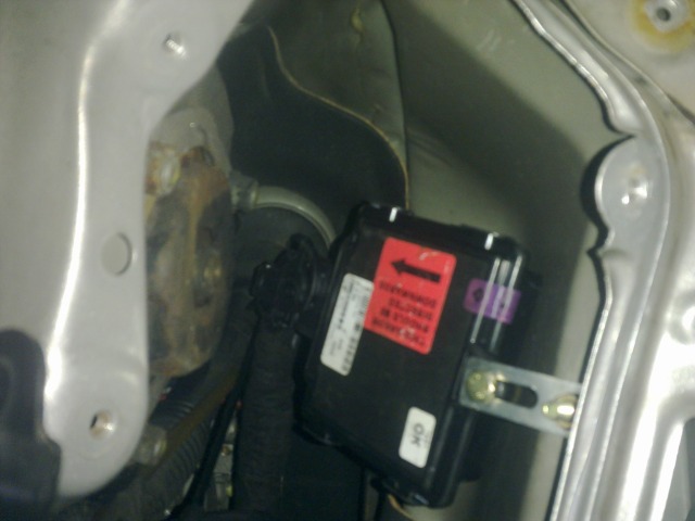

Injector rail mounted
ECU mounted under front scuttle

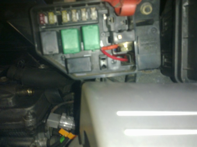

Power taken from main 12 volt connection

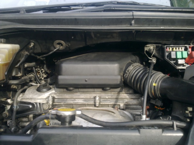

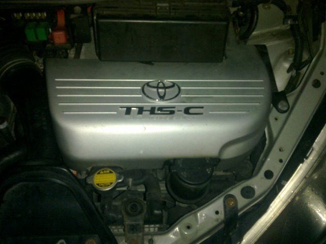

Engine bay after refitting scuttle and air filter assembly
