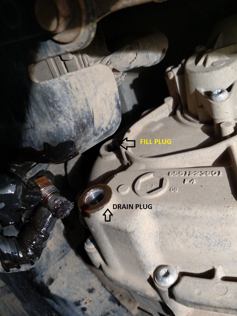

3) Change Front Diff Fluid (2 qts 75W90 Royal Purple MaxGear 01300)
Front diff does not have a cover like the Grand cherokee or most other 4wd's I've worked on. It has a drain and fill plug only.
