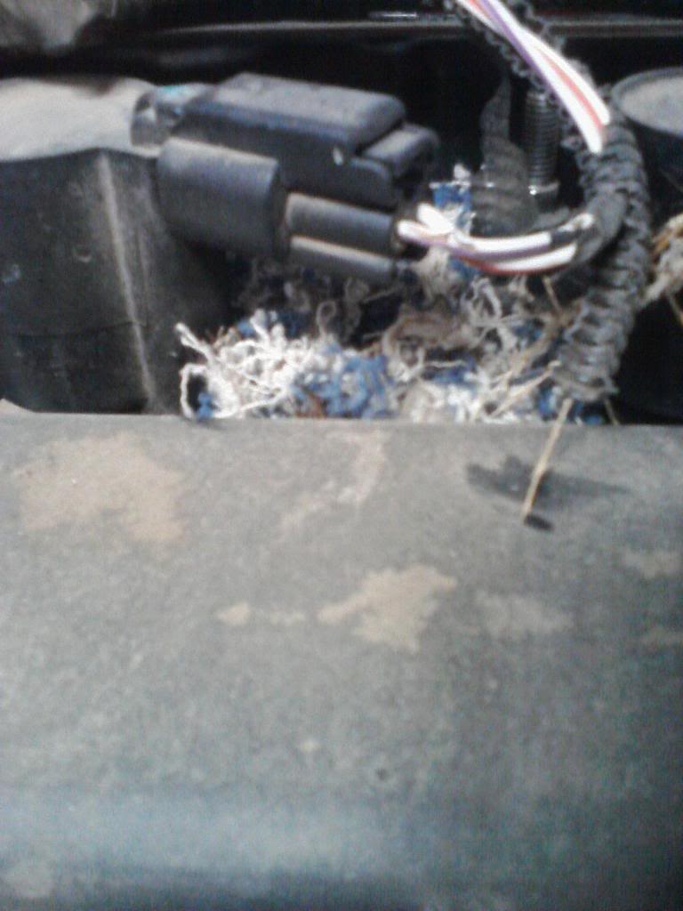

Also while tracking down the noise (it was actualy hard, it was equaly loud on all sides, but could tell it was in the front), I removed the plastic hybrid cover from the plugs, founds a mouse nest next to pass side "spark plul wire' thing, what ever they are called now, and the **** thing ate the black plastic protection cover, and exposed the bare wire of one of the 2 wires inside. Any concern there? just cover with electrial tape?
If I get a better recording of the whirr/grr/wirr noise I'll post it. Hoping it was just due to the extra silent night last night, if that makes sence, it was very quiet out.
Bryan, the tape should be fine if the wires are not damaged, but if your talking about the plug wire on the coil, they require special insulation and that requires replacing. It will not hurt anything if that pump goes out on short trips like that and the most that will happen is the fail safe system will not let you go EV and not provide Assist from the traction motor if things get to hot. A Ford hybrid tech told me these pumps can go Off intermittently and run again also. He said he has played with the wire connections and got the pump running again but ended up just changing the pump later.

Thanks gary, just the wire leading to the plug, so far!
Went out today and key on, pump was running, but normal noise, not the vibrating humm from last night. HVAC was off both times. Last night you could feel the vibration like on the hood release latch, and the plastic.
Will keep an ear open to more noise.
Here's the wire & sound, made with my camera phone, so not great
