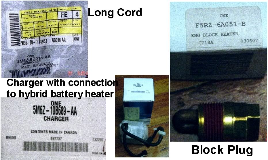

where can i find a picture of the block heater (or plug if mine doesn't have one)?

If you don't see a plug near the radiator, you don't have a block heater.

block heater diy anywhere?

Engine block heater is "option 41H" as shown in the parts below:
Attachment 2604
Only those 05 FEH vehicles sold in the so called nine "northern states" came with option 41H as standard equipment. The block heater plugs/screws into the back of the engine block where one just removes a dummy cover. The charger part fits on the side firewall under the windshield bottle fluid reservoir. The long cord runs out the front grille where one plugs this into an extension cord and electrical outlet.

Where in Minnesota are you? I'm in St. Paul. I've installed the engine block (and HV battery) heater in my '05. Not too hard actually.

If you'd like maybe I could stop up some day or evening and show you how I did my engine block (and HV battery) heater in my '05. Glad to help out. I got the parts from Tousley Ford in White Bear Lake and they were the cheapest in the TC area (<$40 for the block heater). If you're just going to do the engine block heater and not (additionally) the hookup and power supply for the HV battery heater, I've got the power cord for the engine block heater I can sell you cheap.
