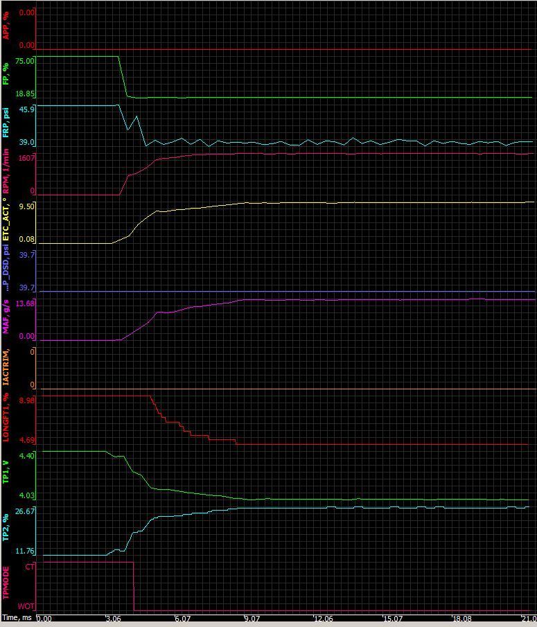

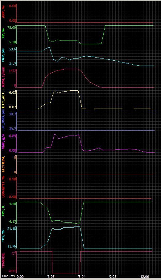

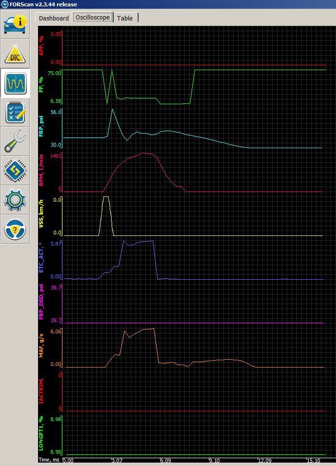

Sometimes in the morning it would start, run for 2-3 seconds and then stall. Recycling a key solved the problem. First time it happened a week ago on a bit colder night (no freezing - just below 45F). Once started - engine worked well for next two days. Then again in the morning - same start and stall. Recycling key first time did not help. But second time did.
Two trouble codes popped up P0A1F-20 and P0A7D-20. But battery itself was fine. After start-up car drives as usual using electric mode.

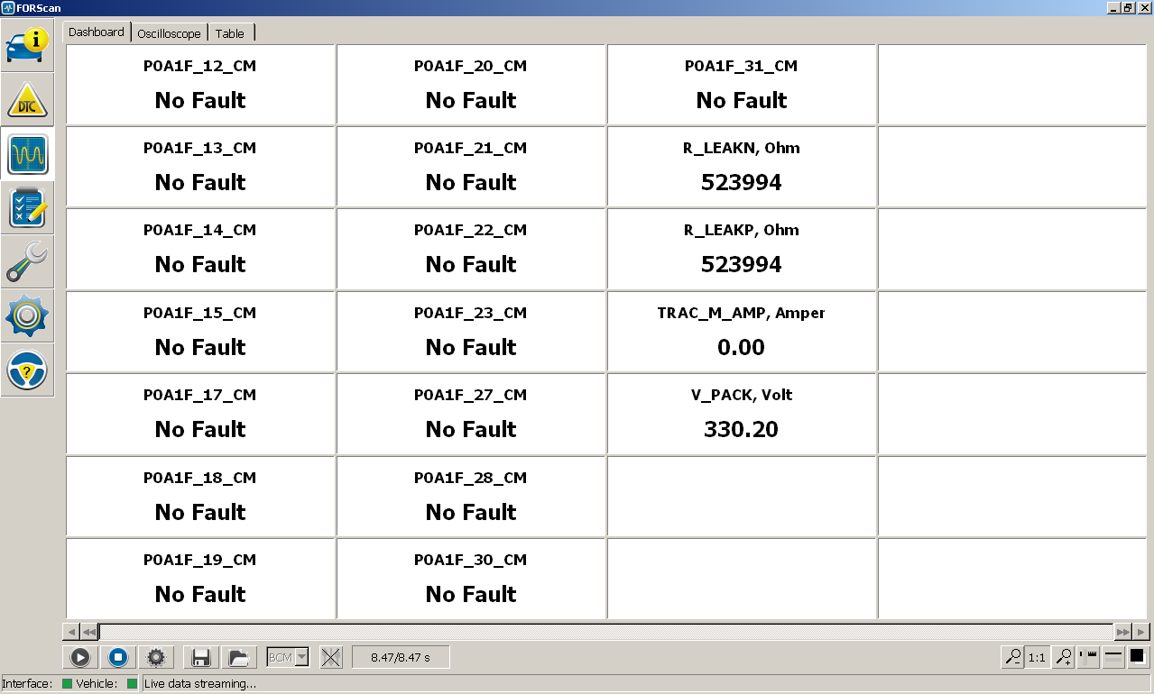

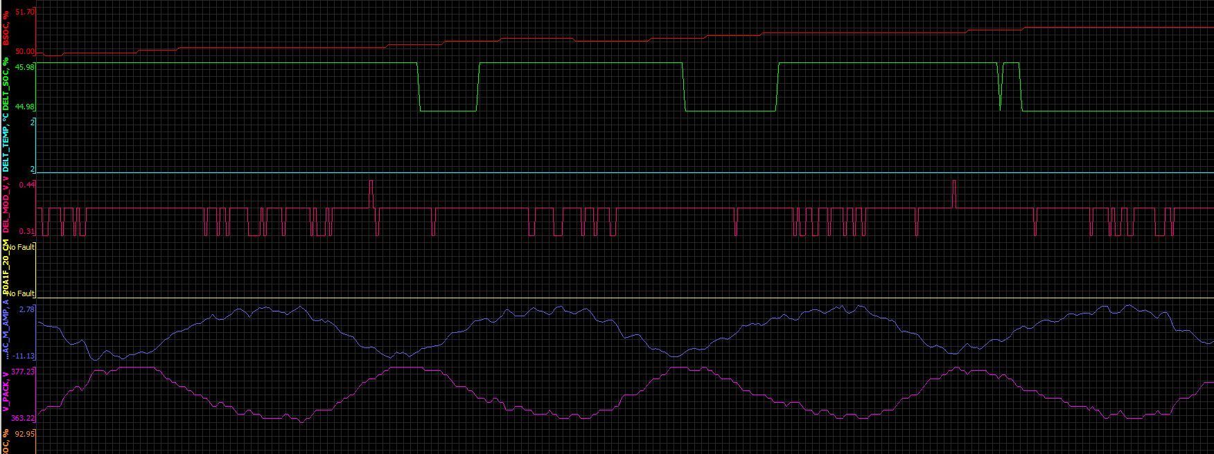

Next morning I've connected Forscan and cuptured some waveform. Some video suggested it might be fuel pump and I do see a bit unusual fuel pressure change on the "failed" start. But not sure is it bad enough to cause the problem. Also MAF is a bit lower and LONGTRIM is quite 8.95 and steady when "failed" start. Any suggestions - what to look at? Any other parameters to capture in order to get a hint? (See pictures below. Also have zip file with Forscan live streaming log files for these in attachment
https://cimg5.ibsrv.net/gimg/www.gre...b7ce50b012.jpg
First recorded FAILED start

https://cimg6.ibsrv.net/gimg/www.gre...37bd58b8cc.jpg
Second recorded FAILED start

https://cimg2.ibsrv.net/gimg/www.gre...109566d057.jpg
Third recorded FAILED start

PRIOR to start, key on, engine off, open the BCM, list items in Table tab and provide a screenshot of the values.
tempvia Dec 2, 2021 10:40 AM
Re: 2007 FEH Intermittent start and stall
Here are the screenshots. It took a while to grab and save the pictures (5-10minutes with key ON, engine OFF). After capturing these I tried starting the engine and it was without any problem.

S Keith Dec 2, 2021 11:22 AM
You can omit the "No Fault" parameters, and readability is improved if you use the table tab as I suggested.
DEL_MOD_V of 0.56 = failing battery pack. Hence why the only codes you're getting are from the BCM.
A healthy back is typically < 0.19 and more often fluctuates between 0.05 and 0.16.
What this means is that the ~25 or so places the battery is monitored, the difference between the highest and lowest value is 0.56V. This is pretty bad, especially since the battery is at a reasonably high voltage with zero current in or out. If this was under a heavy load or charge or at a very low voltage/SoC, then it would be less of a concern, but this is essentially a guarantee that your HV battery is failing. If it had been sitting for months, and you had just resurrected the battery with the HV jump starter, then it wouldn't be an automatic flag, but since this is a daily or near daily driver, it shouldn't be this high.
It's likely because ONE cell out of 250 is about 0.3-0.4V below the others. When a 1.2V cell is 0.4V, it's dang near dead.
Recommend you run the BCM RMODE_BALANCE function in the Service functions.
Recommend you start recording this value, BSoC, V_pack and TRAK_M_AMP.

Other parameters of concern are the charge discharge limits. I don't remember the exact numbers, but the maximums are above 20,000. When these are below the maximums, the BCM is limiting charge/discharge in response to some control parameter. Most common are the battery temperature and SoC during normal operation. The fact that these are less than their maximum limit with no other obvious cause is a concern:
https://cimg8.ibsrv.net/gimg/www.gre...4e53257376.jpg
Given that the delta value never drops to the typical <0.2V range, all signs point to failing cell in the battery.
